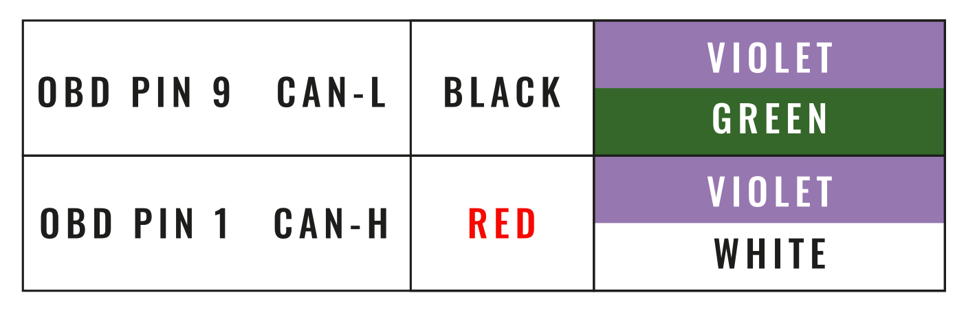

To provide access to low speed CAN you need to mount
ad-on wiring of CAN bus to the OBD socket
according to the instructions in video.

The order number of the OBD pins is: 30656671
