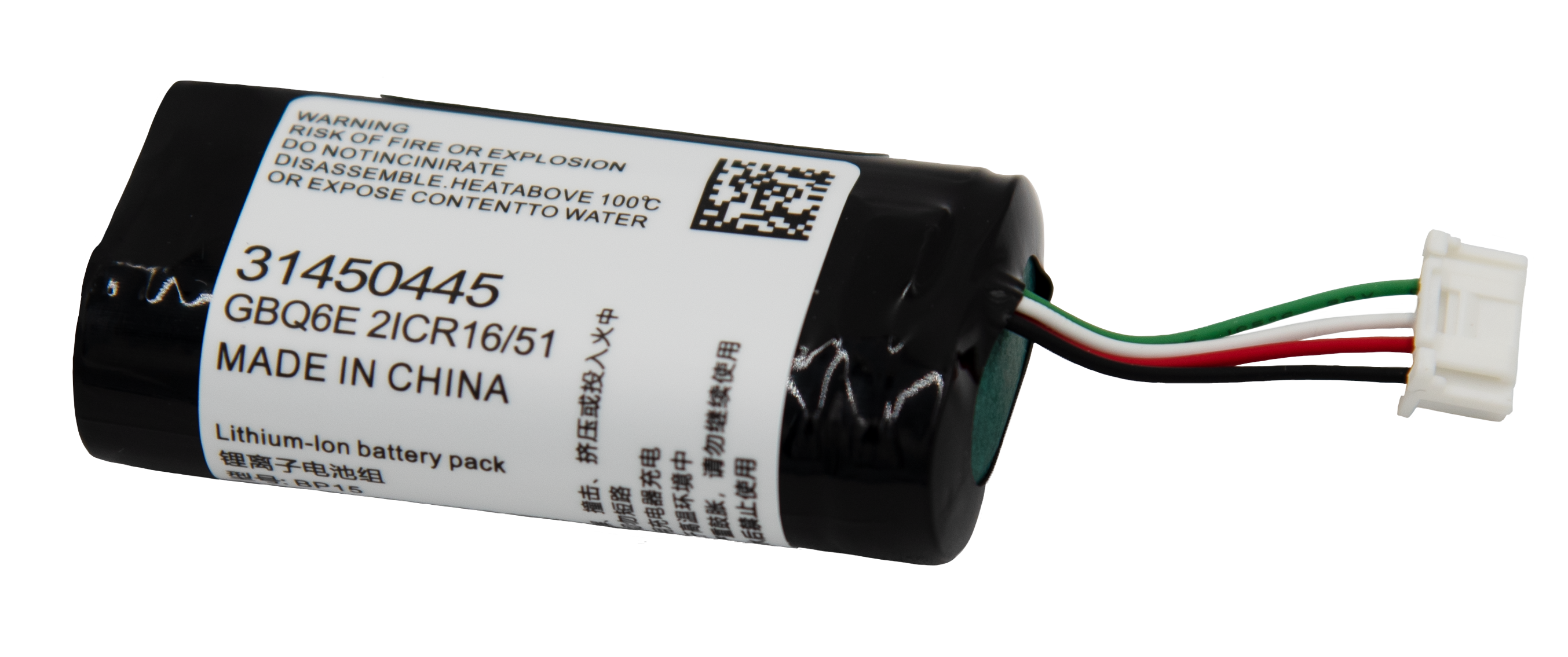

When the VCM backup battery reaches the end of its expected lifetime or drops voltage, the vehicle may display a service warning even if the main telematics system still appears to work. After replacing the VCM backup battery, a software reset is usually required to clear the warning permanently. VDASH can perform this VCM battery reset on supported vehicles.
Common VCM issues
- "Volvo On Call Service Required" message: This warning frequently appears on the dashboard.
- Timed battery life: The VCM contains a small backup battery programmed with a timed life expectancy, usually around 7 to 8 years.
- Battery voltage drop: When the timer expires or the backup battery drops voltage, the car displays a service notification even if the primary telematics system still works.
- Required reset: Replacing the backup battery usually requires specialized software such as VDASH, or a software reset at one of our PRO / PRO Verified dealers, to clear the dashboard code permanently.
