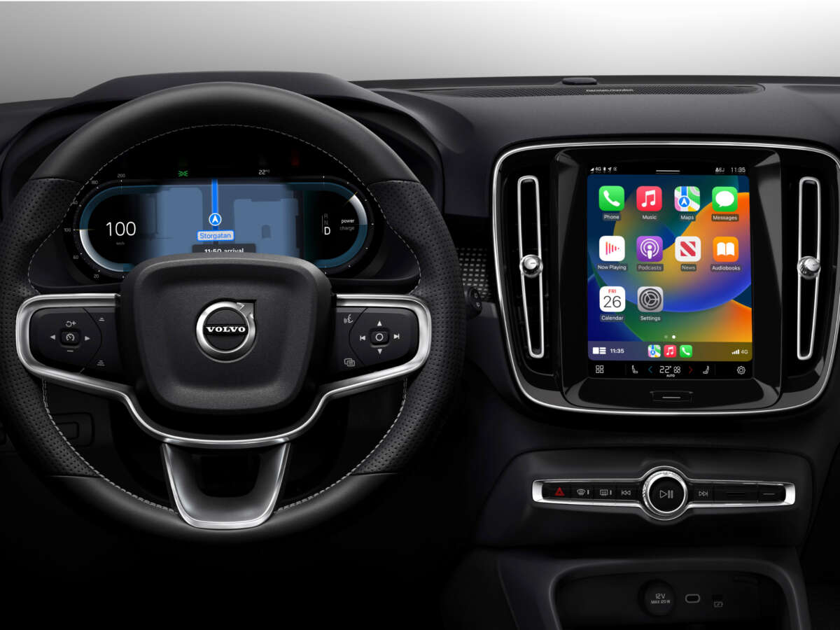

How to Identify an iCUP / Android Volvo
You can identify whether your car is iCUP-based by checking the DIM, Driver Information Module, and the IHU, Infotainment Head Unit. If they look like the example below, your car is equipped with the iCUP / Android-based system.
DIM and IHU
Volvo iCUP Android DIM
